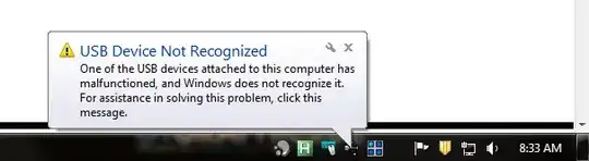

I have a Logitech m525 mouse that I use at work (Win 7 32-bit). For the first little while, I would take the mouse home with me which meant unplugging the Unifying receiver. After a few times doing this however, I noticed that if I plugged the Unifying receiver back into a previously installed port, it wouldn't work. Over time, I've actually run out of ports to plug this device into. I get the following "USB Device Not Recognized" error:
Looking in my device manager, I see that there is a "Unknown Device":
and in the devices properties status I have the following:
Windows has stopped this device because it has reported problems. (Code 43)
I've tried uninstalling and updating the driver, to no avail. I've also downloaded SetPoint, and installed previously when I first installed the mouse. It still doesn't work. My question is two fold:
  1. I have a gut feeling that there are residual corrupted drivers, hence the "Windows has stopped the device...". How do I completely remove ANY drivers associated with this device?
  2. Is there a proper way to install the Logitech Unifying receiver for Windows 7?
