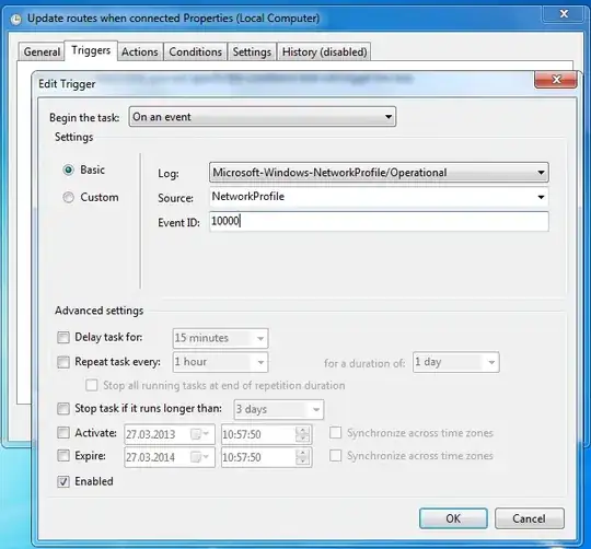

Then add a scheduled task in Task Scheduler to run the batch file with the trigger configured like this:
Task trigger configuration
You may also want to uncheck "Start the task only if the computer is on AC power" on the Conditions tab and select "Run whether user is logged on or not" on the General tab.
The routes should then be updated whenever you connect to a network and you can verify them by running route print - there should be no route to 0.0.0.0 via the real gateway.
