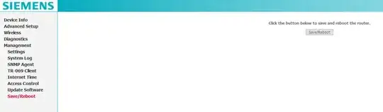

In case anyone lands here wanting to setup their old Siemens SL2-141 ADSL Rouer as as Wireless AP along with another Router as Gateway follow these steps.
go to https://_routerip/main.html
set gateway to your router
set gateway to your main router gateway
Disable DHCP Server from routerip/main.html Disable DHCP Server from routerip/main.html
save/reboot enter image description here
