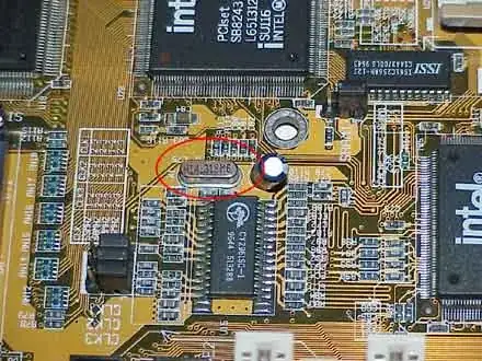

No,
Crystal oscillator
the speed of a CPU is determined by a crystal oscillator - so far as I know this is an external part for most CPUs
crystal oscillator Mobo with xtal
Picture from TechRepublic article
Crystals undergo slow gradual change of frequency with time, known as aging.
However, I suspect this is not a significant factor.
Drift with age is typically 4 ppm for the first year and 2 ppm per year for the life of the DT-26 crystal.
(from TI concerning an RTC IC but I believe this rate is similar for timing crystals in general)

A few extra bits and pieces about some of the other answers.
  1. crystals can/do slowly drift over time, but they're much more affected by temperature than time. For example, right when you turn on the machine, it's probably running a bit different speed than when it's been running for hours. These differences are, however, much too small to be perceptible.
  2. It is entirely possible to have an intermittent failure in connections on a chip. When fabricating a chip, they (obviously) do their best to prevent this, but it's still possible and does still happen. As chips have started to run hotter, this has become more common. When/if this happens, however, it's a lot more likely to cause the machine to shut down completely than run normally, but slower than it did. That's not to say that a slowdown is impossible, just very unlikely.
  3. While self-correction can detect errors and shut down parts of a CPU, the CPUs in (at least most) current PCs don't include such capabilities. For this, you're looking at either a high-end mainframe, or a PC of the future (though, admittedly, not all that distant of a future any more).
