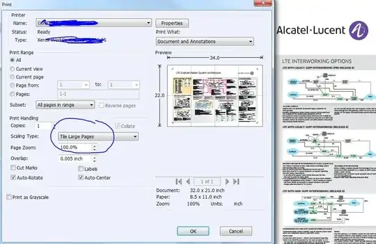

I printed Alcatel Lucent LTE poster just now which is PDF format. In the printer property just choose scaling type 'Tile large paper'.
enter link description here

Use Foxit Reader and while printing select tile large pages and Adjust Zoom and overlap as per your wish.
Or use Adobe PDF reader and in print command dialogue box select Poster and Adjust Zoom and overlap.
    Your post needs to be expanded. In its current form it does not provide enough information to actually *[answer](http://superuser.com/help/how-to-answer)* the OPs question. You should include specific steps to implement your solution and explain why/how your answer addresses the OPs question. – I say Reinstate Monica Jun 01 '15 at 13:05
  • Currently I don't have 10 points hence i can-not add pictures. This will be approximately similar to the screenshot "Alcatel.Lucent" posted above in the reply of this question. – Purnendu Kumar Jun 02 '15 at 19:10
