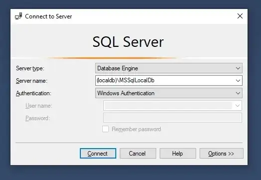

Step 1
You want to connect it locally. It works sometimes writing the name of the your machine (not case sensitive). Although you have an alternative, Only if your machine name doesn't connect.
Essentially, just paste this into the connection window:
(localdb)\MSSqlLocalDb
Or like shown below: Server
