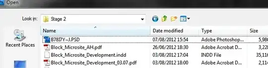

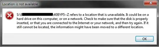

All GFX designers use Mac and create folders/files on the file server over AFP and programmers access those files using samba. Sometimes files and folders appear with weird names and become inaccessible to those connecting over samba.
The only way to make the created folder accessible is go back onto a Mac desktop got to the location of the folder, create a new folder and move the contents of broken folder to the new one.
On the Mac desktops they can access the folders perfectly fine and the folder/file name appears as they were created. It's just PC users accessing over Samba that has the file/folder issue. Whats weird is that this happens at random and I cannot find any reason why some files folder end up not working for samba users. I suspect that the mac users are doing something to that file/folder such as adding a flag or some property thats compatible with the Mac file system but causes problems with samba.

It's a file name mangling problem. Samba is converting filenames down to old style DOS 8.3 filenames.
Edit /etc/smb.conf (*) and add mangled names=no to the [global] section and restart the smb service.

The problem was only affecting a single user's directories (when viewed by others) and every mangled directory name was in the format of six(6) uppercase characters or numbers, one(1) ~ (tilde), followed by a single uppercase character or number.
Examples:
G2X4IA~5
O2T3KH~K
SYJ2IT~R
Solution:
The MAC user(s) in question should stop using trailing spaces and/or special characters in directory names. That's it. Almost every one of the directories in question had a trailing space, and the rest had a trailing special character (one actually had both which was a good test case). Simply removing them immediately cleared things up.
