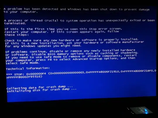

I'm getting frequent Blue Screens (every hour or two), with a STOP 0xF4 code. The really fun thing about these is that no crash dump is ever generated. As shown in the screen shot below, it says that it is initializing the disk for crash dump, but nothing ever happens (this blue screen was on all night).
"Screen shot"
On the first blue screen that I saw (which I didn't pay much attention to, as I assumed it was a one-off), I believe that it listed ntfs.sys as the problematic file - I can't remember what the STOP code was. There was no dump generated.
I've run a Windows Memory Diagnostic (Standard, 2 passes) and no errors were found. I've also run a chkdisk on my main Windows hard drive (SSD), with no errors found. I haven't had a chance to run chkdisk on my other drives yet...
These blue screens all started yesterday, and I haven't changed any hardware recently. I don't believe anyone has installed any software around that time frame (at least, none showing up in Add/Remove programs).
What should my next steps be? Any ideas about the cause?

A friend pointed me toward the likely culprit: My Crucial m4 SSD, which has known BSOD issues after 5000 hours of use. I'm going to update the firmware tonight and report back tomorrow.

The Crucial m4 SSD has a known BSOD issue after about 5000 hours of use. I updated the firmware, and my blue screen issue was resolved.

Maybe generating Memory Dumps is deactivated. Check if you can enable it: http://support.microsoft.com/kb/235496/en-us
BSOD 0xF4 occurs when a critical process is killed. It is important to know which process got killed in order to solve that problem. I suggest enabling crash dumps and analyzing it. Have a look in your eventlog, too. Maybe you can find some useful information there. BSODs are generally logged as "System error".

  • Thanks for the link. I'm 99.9% sure that memory dumps are enabled (I have a dump from an unrelated blue screen from 2 weeks ago), but I'll double check that when I get home. And I'll check the event log as well. – Eric Aug 08 '12 at 15:12
  • If crash dumps are enabled but there's none it could be that you restarted your system too early and didn't wait for the crash dump collect to finish or the drive or something related to the harddrive is bad and the crash dump couldn't be written. – wullxz Aug 08 '12 at 15:16
  • The BSOD was up all night with no dump. The hard drive thing sounds like a possibility, but `chkdisk` didn't find anything wrong. Is there a better hard drive test I could do that you know of? – Eric Aug 08 '12 at 15:20
  • I don't have a SSD drive and therefore I've never tried any tool to check a SSD but [this](http://www.addictivetips.com/windows-tips/monitor-and-check-health-status-of-ssd-drives-with-ssdlife/) looks like what you need. – wullxz Aug 08 '12 at 15:33
