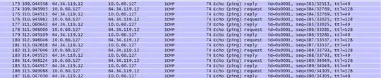

We can further proof this behavior by examining the behavior of ping with Wireshark
When running ping -t superuser.com we see the following output in Wireshark:
Now, let's mark a box in the command prompt.
Suddenly, no more pings are logged in Wireshark. ping is no longer sending any packets.
But we already knew that...
Right, let's see if the output is actually the issue here! Let's direct the output to the NUL device:
Now, there is no longer any ouput. We can now mark text in the box all day long, packets will be logged in Wireshark.
