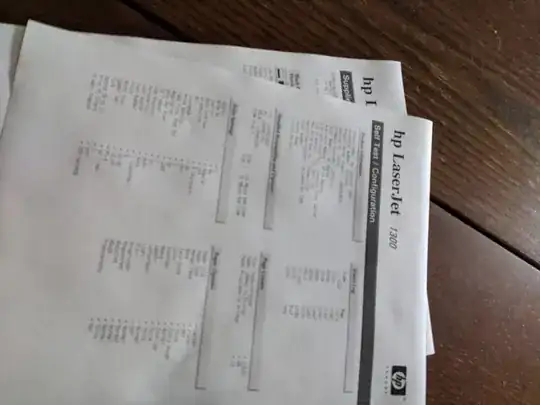

And here are the test pages after replacing the board:
test pages after replacing zEngine Controller Board

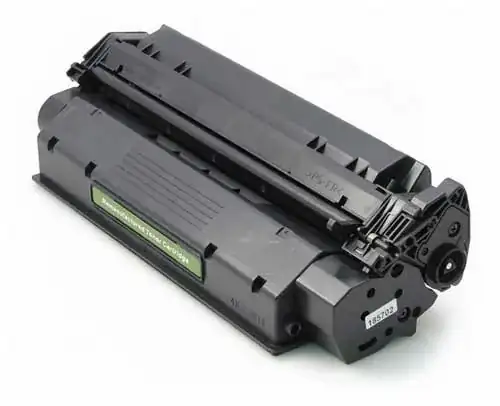

Before replacing the toner, try cleaning the drum with some cleaning paper (toilet paper might do the trick), this is the (usualy) green roller hiding behind the protection you will need to lift. If I recall correctly, this protection is on the right side on this picture. Try printing to see if it got any better. Good luck!
Image of the 15A toner cartridge
