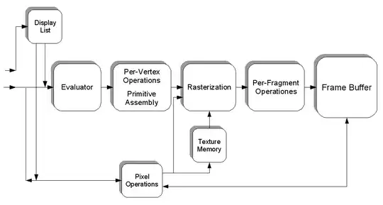

Transformation
Image source
Transformation is the part where we take all the input coordinates (the vertices of our triangle) and apply our ModelView matrix. This is the matrix that explains how our model (the vertices) are rotated, scaled, and translated (moved).
Next, we apply our Projection matrix. This moves all coordinates so that they face our camera correctly.
Now we transform once more, with our Viewport matrix. We do this to scale our model to the size of our monitor. Now we have a set of vertices that are ready to be rendered!
