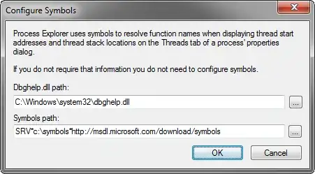

If your troubleshooting requires you to get more detail, it is often very helpful to load debugging symbols into Process Explorer. This is how:
  1. If you don't already have a Windows debugger installed, you're going to have to install the Debugging Tools for Windows first.
  2. In Process Explorer, open Configure Symbols... from the Options menu:
  3. If you have the Debugging Tools (or another Windows debugger) installed, Process Explorer will automatically find the dbghelp.dll file. Otherwise, set the correct path here.
    The Symbols path should look something like:
    SRV*C:\Symbols*http://msdl.microsoft.com/download/symbols
    The only part you'll want to adjust is C:\Symbols. That's the location where the debugging symbols will be cached.
