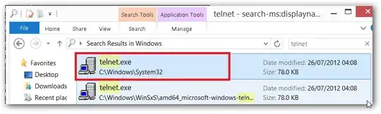

I installed the Windows telnet client (telnet.exe) on Windows 8 Enterprise Edition (RTM - fresh install) via Turn Windows features on or off. However I can't seem to launch it from an Administrator command prompt.
I did a full search of the C: drive and can see the executable residing in C:\Windows\System32:
telnet search result
I can also see the executable in explorer:
telnet in explorer
In both of the above cases I can launch the client by double clicking but for some reason it's not visible in my Administrator cmd.exe command prompt (or PowerShell for that matter):
run telnet in cmd result
Also, as you can see in the above screenshot, C:\Windows\system32 is present and correct in my PATH environment variable. Other system executables launch just fine (tasklist.exe for example).
For reasons that are too long winded to explain I can't use a third party telnet client such as PuTTY.
Can anyone shed any light on why this is happening?
I also tried a reboot but that's not helped either.

This is because of the file system redirector. A 32-bit process won't see the real Windows\System32 folder but get the content of the substituted Windows\SysWOW64 instead
To get it work on 32-bit cmd.exe or any 32-bit shells you can run
cd %windir%\Sysnative\
to change the working directory to that real System32 folder and then run telnet normally. Or just run %windir%\Sysnative\telnet directly to open 64-bit telnet.exe
Another way is to force open 64-bit cmd.exe from a 32-bit process (like ViStart) by modifying the invoking command or shortcut to %windir%\Sysnative\cmd.exe
Alternatively just copy (or create a hardlink) the telnet.exe file from System32 to SysWOW64
You can also add %windir%\Sysnative to the %PATH% environment variable after %windir%\System32 so that after checking that the file doesn't exist in System32 it'll continue looking in Sysnative

I finally got to the bottom of this. I had installed ViStart after becoming increasingly frustrated with the new Windows 8 Modern UI and which is particularly tricky to use over a Remote Desktop Connection.
I was using ViStart to do my usual muscle memory Start->Run->cmd.exe as I would on Windows 7. However, it turns out that ViStart is a 32-bit application and launches a 32-bit command prompt. Of course, this command prompt being 32-bit can't see telnet.exe because it's a 64-bit exe etc.
I have since given up on ViStart as a bad idea and have resigned myself to learn to navigate Modern UI instead.
