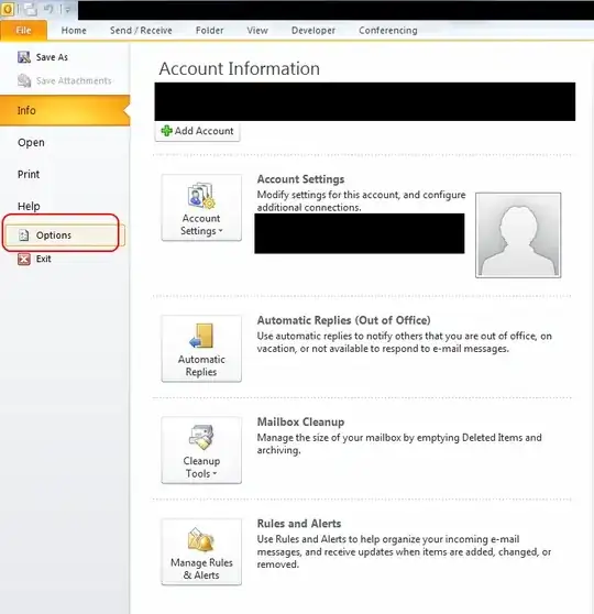

Click Options: click Options

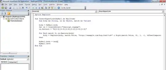

Double click on the ThisOutlookSession module and paste in the code as follows: Put in the code
And now, the code:
Option Explicit
Sub InsertHyperLink(MyMail As MailItem)
    Dim body As String, re As Object, match As Variant
    body = MyMail.body
    Set re = CreateObject("vbscript.regexp")
    re.Pattern = "#[0-9][0-9][0-9][0-9][0-9][0-9]"
    For Each match In re.Execute(body)
        body = Replace(body, match.Value, "http://example.com/bug.html?id=" & Right(match.Value, 6), 1, -1, vbTextCompare)
    Next
    MyMail.body = body
    MyMail.Save
End Sub

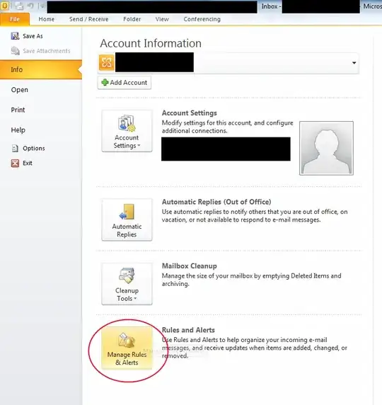

Go to Manage Rules & Alerts: Go to Manage Rules & Alerts

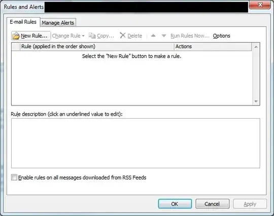

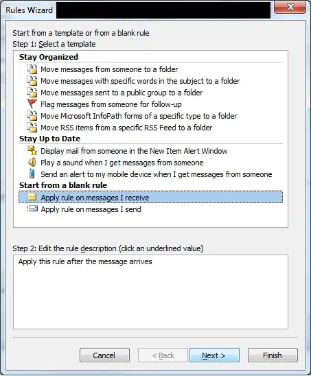

Click New Rule...: Click New Rule...
Click "Apply rule on messages I receive", then click Next: Apply rule on messages I receive

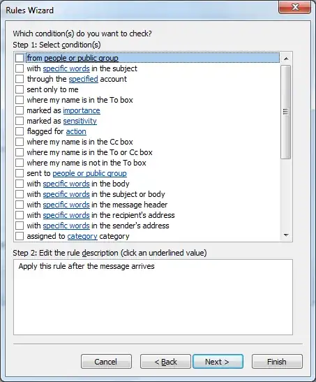

If you want to only run the rule on certain messages, you can select from any of the conditions here. Don't worry about filtering on messages containing "#123456" in the body; we do that in the code. So just filter on, for example, "From:" or the Subject, if you want. This is optional. Select conditions

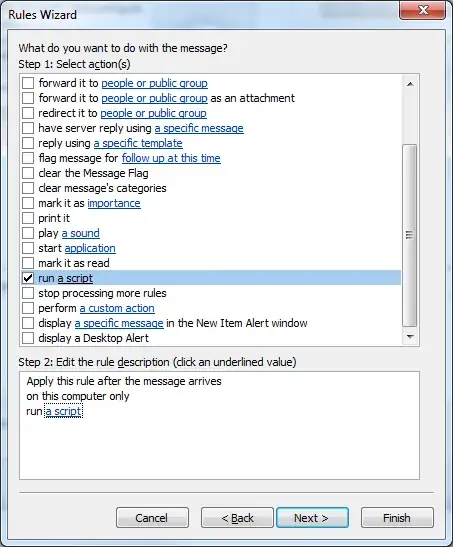

Choose "Run a script". Click on the text that says "a script" in blue underline in the bottom box. Run a script action

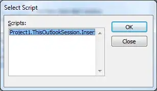

Pick the script we just created, whose name will probably be cut off due to the small dialog, but that's OK.
Pick your script
