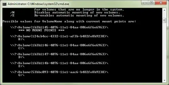

You can use mountvol in the command prompt to get the ID of the volume you want to access.
This IDs can be used to open an explorer window, independent from the drive letter
To create a shortcut to the drive, create a new batch file with this content:
start \\?\Volume{1b3b1146-4076-11e1-84aa-806e6f6e6963}\

  • Yes, it is what I searched for long! Now I just need to call the mountvol command to get all volume ID's. Then using path like "\\?\Volume{}" I can access to drive with needed ID (if it presents). Thank you! – olvin Aug 24 '12 at 08:10
    Yes, this method works with Explorer and while copying files with command line. But unfortunatelly TrueCrypt does not accept such path to a keyfile =( – olvin Aug 26 '12 at 20:55
  • Unfortunately it only works if you have NetBIOS and the RPC Locator running, so this won’t work if you have hardened Windows. In addition, you’ll probably need to keep several network-related services and drivers running to use it (Workstation, Computer Browser, Server, TCP/IP NetBIOS Helper, NetBT, DHCP, DNS, etc.) This is dumb since these are local volumes. `:-|` – Synetech Apr 12 '14 at 22:30
    Well.. TrueCrypt does support this for reliably mounting the right drive: `@"%ProgramFiles%\TrueCrypt\TrueCrypt.exe" /v \\?\Volume{4033aabd-1234-5678-a1234567890}\ /lr /c n /q` – Frank N Oct 11 '15 at 13:12
  • @Synetech: I can't replicate that; the answer as posted works fine for me even with NetBIOS and the RPC Locator, and everything else network-related I could find, disabled. (Perhaps you were mistaking the kernel path for a UNC path? Or it was only a problem on an earlier version of Windows?) – Harry Johnston Jan 11 '16 at 21:14
  • Unfortunately this doesn't work when you type this into folder's address bar, or when selecting folder with folder select window (i.e. when moving documents folder to a different location) – vanowm May 24 '20 at 03:54
