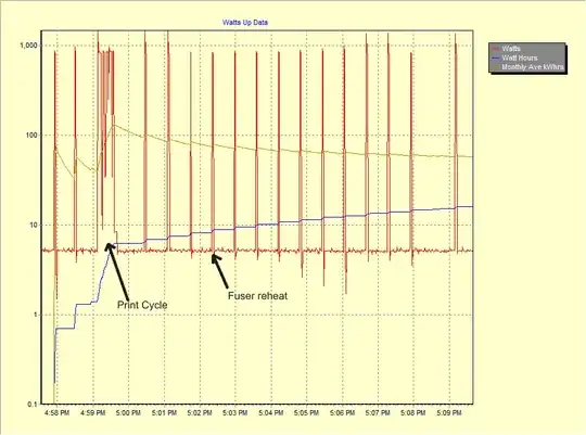

Here is an example of power used vs time.
Brother 5250 current draw
From http://www.johndearmond.com/2008/08/04/laser-printers-and-inverters/
