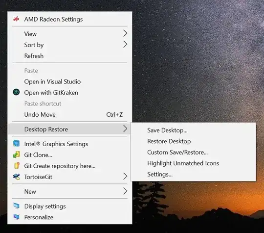

Just installed DesktopRestore from midiox, which works fine on Windows 7 and 10. Just right click on the Desktop to see the menu -

3Don't know why this was downvoted. This is a great answer and an awesome solution. I have been using Jamie O'Connell's Desktop icon Save and Restore for over a DECADE now, and still using on Win7 x64. It's invaluable especially for when you are switching between a multi-monitor setup at work and a single-monitor (laptop) at home. You can set up different layouts that are super easy to restore contextually based on the monitor setup. The link to the (free) application is on Jamie's website: http://www.midiox.com/html/desktop.htm – Tom Auger Jun 20 '15 at 01:29
2That's not true. I use it on Windows 10 and it seems to work perfectly fine. – Gal Talmor Jan 25 '17 at 23:47
On Win10 menus seem to behave weirdly (won't drop down; double clicking any of them instead changes language) while keeping the program window open during screen changes. – user66001 May 09 '17 at 21:46
2Downvotes may come from the fact that currently 26 of 64 engines in [https://www.virustotal.com/](https://www.virustotal.com/) report the chip.de installer as malicious, probably due to adware injected by download site. I've edited the answer and changed the link to the official site. – Álvaro González Sep 09 '17 at 07:49
