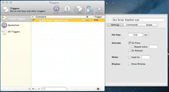

  4. launch QuickSilver and navigate to Preferences -> Triggers -> Custom triggers
  5. create a new trigger, in which you open StepOver.scpt script using the hot key you want (in the screenshot I've used F10). In the Scope tab you can specify that the trigger only works in Xcode. trigger example
  6. at this point the additional shortcut should work, I've built a basic console C++ application in Xcode and I could step over using using F6 (as "standard" shortcut) and F10 (as additional shortcut configured with QuickSilver).

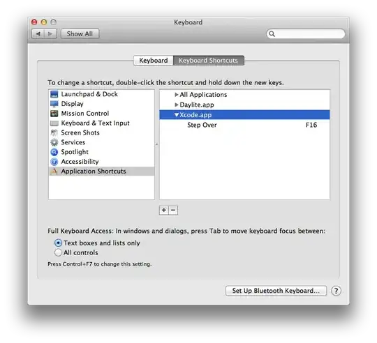

I do this with Keyboard Maestro. You can assign a command to one or more applications or global. It's a fantastic piece of software I can't live without. It's the best piece of software I've ever bought. You would be shocked to see how many key bindings I have.
Attached is an image where I map a hotkey to a menu item. Ignore the action grayed-out in the image. It starts off with "Execute Macro". Menu Select is the action you want
You can use the keyboard shortcut mapper for this process see attached image.
I hope this helps you
  • I was so hopeful this would work! When I tried it, only the F16 keyboard shortcut worked, and F6 no longer worked from within XCode (it just made the error sound instead of doing anything). The system level mappings seem to overwrite the app level mappings. I'm using XCode 4.5.2 and OSX 10.8.2. Did this work for you, and what versions are you using? – joseph.hainline Dec 18 '12 at 03:42
  • Hi there sorry it wasn't complete;y correct use ctrl+f6 this will work alongside f16 that is the best I think you can get my apologies. – Justin Erswell Dec 18 '12 at 08:37
  • Thanks for the attempt, but I guess what I'm looking for is simply not possible. Ctrl+F6 is a different command than F6. When I map at the system level, it just overrides the app level. I'm really trying to get two keys mapped at the same time to the same function. – joseph.hainline Dec 19 '12 at 03:14
