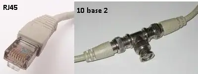

Assuming your Ethernet is connected via a RJ45 plug:
No. A simple splitter will not work. You can use a switch or a hub though.
(RJ45 mentioned because you can do what you want if you used old coax to connect. Feel free to google for 10base2_t, but this is very unlikely)
Hennes
  • 64,768
  • 168
  • 10B2! How quaint! – Isaac Rabinovitch Sep 10 '12 at 04:12
  • Aye. Truly ancient. But there still are devices alive which use it. Even if my last coax switch died. (And yes, I meant a switch, not a hub. Back in the days of yore it cost as much as a small car and it was quaint enough that I saved it from the trashcan). – Hennes Sep 10 '12 at 11:29
