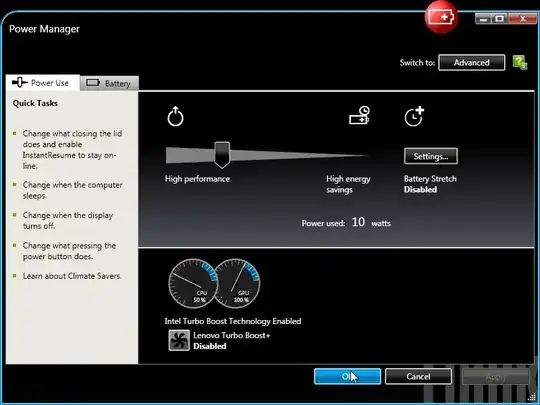

Update Maybe there is a problem with the integrated Intel GMA 3000 Card. The Power Manager shows it at 100% at all times:

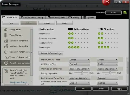

I think it is likely that the Linux boot and/or the dual boot with Windows 8 somehow changed the motherboard settings for the fan control. I would proceed with:
  • Check the settings for fan control in the ThinkVantage Power Manager (use the Advanced view), see Advance Power settings. Check if the Linux OS changed essential settings for the predefined power agendas. Especially check the settings for what the computer does when idle.

  • I updated my question, maybe it is graphic card related – Igor Kulman Sep 07 '12 at 08:44
  • Select the "Advanced" part of the Power manager. In this section, you can control the settings on a more detailed level, especially when & how of energy consumption (and fan). – FredrikD Sep 07 '12 at 13:07
  • it is set the same way as Bios, balanced on battery an pefromance on AC and the fans spin at max even on battery – Igor Kulman Sep 07 '12 at 14:33
  • So it works as it should when you use tpfancontrol and when the computer has been inactive, the fan goes back to max? – FredrikD Sep 09 '12 at 15:03
  • yes. My Power Manager looks like your screenshot, the settings are the same as in BIOS and look ok – Igor Kulman Sep 09 '12 at 21:30
