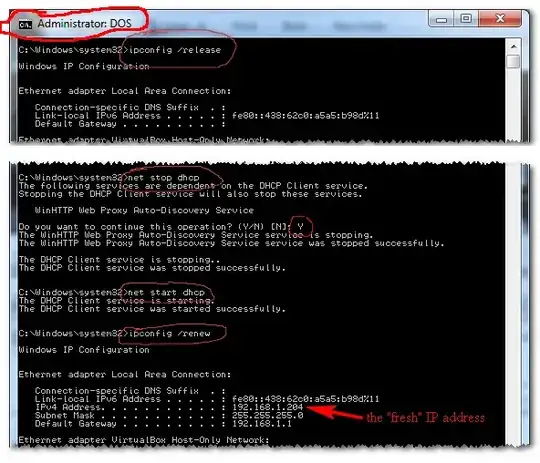

Running net stop dhcp and then net start dhcp appears to work on my Windows 7 test system. The resulting DHCP discover packet does not include Option 50.
I guess it's your choice if you want run ipconfig /release first in order to signal to the DHCP server that the IP address is available (it should remove the existing lease on the DHCP server).
So, to summarize, the whole process would be (in an Administrator cmd window):
ipconfig /release
net stop dhcp
net start dhcp
ipconfig /renew
If you wanted to indicate only a connection matching Local* (for example, Local Area Connection), then you could do:
ipconfig /release Local*
net stop dhcp
net start dhcp
ipconfig /renew Local*
Screenshot

    Just checked. Does not work. – Basilevs Sep 07 '14 at 16:31
    Work for me. I did (in administrator cmd window): `ipconfig/release` then `net stop dhcp` then `net start dhcp` then `ipconfig/renew` and I got a new address. – Gregor Mar 12 '15 at 21:22
    `ipconfig /renew Local*` just prints the interface info, as if I typed `ipconfig` with no arguments. Edit: nope! It prints the info (for all interfaces, not just ones matching Local*) *and* renews the lease. – Kaz Jun 24 '15 at 19:24
    this worked for me, but i also cleared out the dhcp leases and dns forward/reverse lookups – Pete Jul 30 '15 at 00:46
    This also worked for me using an admin cmd prompt. – Bibz Aug 05 '15 at 13:23
