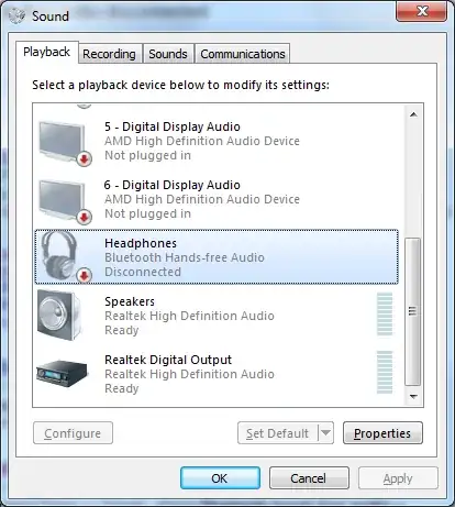

Now my headset appears in both Playback and Recording, but shows as Disconnected. The device is on, paired, and appears under "Device Manager" as having no problems. I right-clicked and installed both the Hands-free Telephony and Headset services.
Here is an image:
Right-clicking the device and selecting Connect does nothing. Does anyone have a solution?

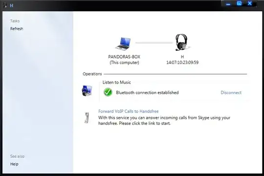

This question is a year old but I had the same problem and solved it a different way and just wanted to share the solution that worked for me:
1. Go to Devices & Printers
2. Right Click the icon for the headphones
3. Select "Services" (I didn't have Control like the first answer suggests)
4. An interface pops up and shows a list of operations
5. Under list of operations I have Listen to Music
6. I don't exactly remember what the name of the button under Listen to Music was but whatever it is, if you click it, it will do some voodoo and you'll suddenly have your headphones connected and working.

  • The button is "Listen to Music". once you press it, then the screen like your screenshot appears. Thanks a lot. Worked for me. – skm Sep 20 '16 at 13:10

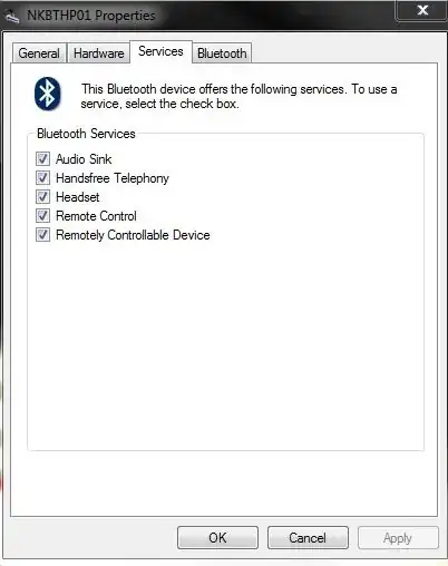

  • Go to your Bluetooth icon left click it menu will open
  • Go up click Show Bluetooth devices left click it now your in the Control Panel\Hardware and Sound\Devices and Printers
  • Place your device in pairing mode and hit Add a device when you see your device click on it to add it and the drivers
  • After your drivers have installed, go Back to Control Panel\Hardware and Sound\Devices and Printers Now right click on your bluetooth headset
  • Go down to properties left click
  • Now your in the headphone properties go over to Services left click it
  • Now click or highlight these boxes
    1. Audio Sink
    2. Handsfree telephony
    3. Headset
    4. Remote control
    5. Remotely controllable device
  • After highlighting or checking these boxes click Apply and more drivers will install after drivers finish
  • Now Reboot your laptop or pc
On some headphones there are more options but these are the only ones that i have used when connecting to my laptops
I have Hp laptops #1: Dv7 and #2: G Series both with two different Bluetooth toggles installed
Settings are the same for most headphones and all i have owned hope this helps.

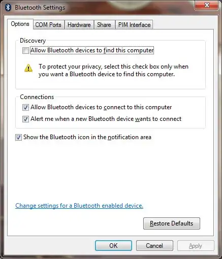

A place to check is Bluetooth settings and be sure Allow Bluetooth devices to connect with this computer box is checked.
This from Windows help:
To control how your computer pairs with Bluetooth devices Click to open Control Panel.
In the Control Panel search box, type Bluetooth, and then click Change Bluetooth settings.
In the Bluetooth Settings dialog box, click the Options tab and do any of the following:
To make your computer discoverable to Bluetooth devices, select the check box for Allow Bluetooth devices to find this computer.
When a Bluetooth enabled computer is in discovery mode, it broadcasts a wireless signal that allows it to be detected by other Bluetooth enabled computers or devices. This is sometimes called pairing mode.
Warning To help protect your computer from someone accessing it without your permission, only make your computer discoverable when you want a Bluetooth device to find your computer. Disable discovery when you no longer need it.
To allow Bluetooth devices to connect to your computer, select the check box for Allow Bluetooth devices to connect to this computer. enter image description here To be notified when a Bluetooth device is trying to connect to your computer, select the check box for Alert me when a new Bluetooth device wants to connect.
The Options tab in the Bluetooth Settings dialog box

    Thanks for the reply. However, the settings were already set to allow devices to connect to the computer. – Mike Sep 08 '12 at 21:31

I just wanted to post a more up to date version of the current selected answer. I went to the devices and printers window as well, but from there I:
  • Right clicked the bluetooth headphones and clicked services
  • Then I clicked Listen To music
And I saw my headphones in playback device options go from disconnected to ready almost immediately.

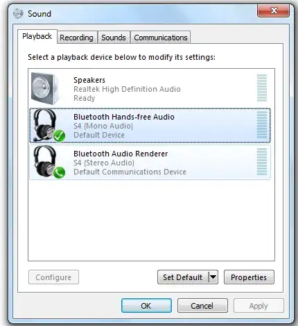

After trying several drivers and configurations, I resolved a similar problem by simply setting as default device the Bluetooth Hands-free audio device.
Setting the Bluetooth Hands-free Audio device as the default device
After driver installation default was Bluetooth audio renderer device, I had to change the default device. Now it works seamlessly. No more disconnections

  • You should post the setting default info here - if the link breaks in the future your answer would become devalued. – suspectus Oct 20 '15 at 08:22
  • @suspectus The setting default info is shown in the screenshot which has been embedded. – karel Oct 20 '15 at 09:58
