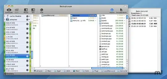

Check out BackupLoupe – it gives you some great ways to navigate across your Time Machine backups.
