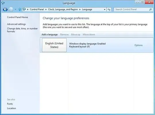

Check the Control Panel. Which languages do you have installed? If you have only Norwegian, try adding English as well:
You can then switch languages from the language icon in the taskbar.

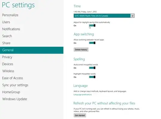

You can also press ⊞ Win+C to bring up the Charms bar, select Settings / Change PC settings / General and modify the Spelling and Language options as required:

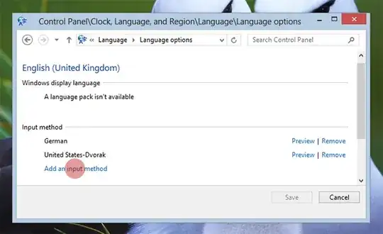

Add English to the language list and make it your primary language by moving it to the top. Now click the Options link:
Here under Input method you can Add an input method:

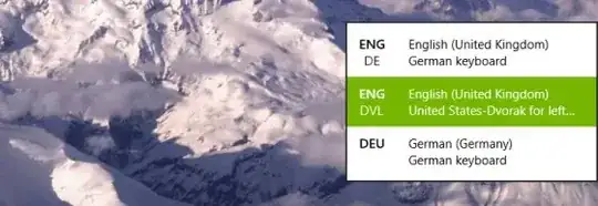

So now you can have English as the input/proofing language but German as the input method/keyboard layout. You can subsequently press ⊞ Win+Space to switch between available combinations:
