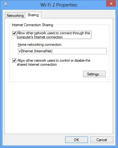

What appears to have been the problem is that the bridging protocol was not supported by the AP (access points) of my university.
Here is the workaround (as far as I can tell this way is more robust than the bridging way that is done by default, but there might be some additional overhead (not sure how much)):
  1. Create an internal network switch
  2. Connect it to the guest OS
  3. Connect the internal virtual adapter to the virtual adapter created by Hyper-V like so: enter image description here.
    Go to the adapter that provides internet access to the machine, and then click sharing. Select the adapter created in step 1.
  4. Everything should work well.
Credit for this solution goes to the networking people at Binghamton University, more specifically Joe and Alan.

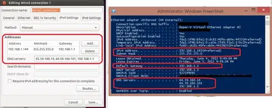

soandos's solution did not reliably work for me. Instead, liuhongbo's suggestion worked. The following was the setup that worked reliably. The network settings from within the Ubuntu virtual machine are on the left, and the ipconfig listings from Windows 8 are on the right.
Ubuntu and Windows 8 Network Configurations
Notice that the Subnet Mask, Default Gateway, and DNS Servers are the same both from within Ubuntu and within Windows 8. The only difference is the IPv4 Address, which is different only by one digit.
