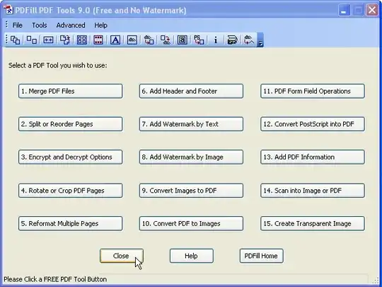

PDFill PDF Tools is probably the easist way to convert your PDFs to images on Windows. It'll let you export all the pages in the PDF to separate images in one shot. It also has a lot of other features available for free, which are only available in other PDF viewers if you purchase the commercial or "Pro" version.
Use the "Convert PDF to Images" button (button #10) in the screenshot below.
PDFill PDF Tools screenshot
If you need to concatenate the images into one very tall image so you only have to feed one file to your OCR program, you can use IrfanView

  • note that this will install two different tools on your system. The main one being PDFill Editor, which is the one you don't need. Go into start menu to open this one. I was saved by the screenshot realizing that something was wrong before I uninstalled. – ufotds May 07 '11 at 19:59
  • Yes, I guess I failed to mention that it also installs a shareware version of PDFill Editor, as well as a PDF printer. Any files created with PDFill Editor will have a watermark unless you buy the editor for $19.99, but the PDFill PDF Tools Free utility doesn't require any purchase. In the version I have, you can't uninstall PDFill Editor without also uninstalling PDFill PDF Tools Free, but having PDFill Editor installed doesn't harm anything. – rob May 09 '11 at 18:08

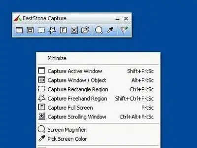

If the image exceeds the size of you screen, you may use FastStone Capture (the "Capture Scrolling Window" feature) and save the image as a JPEG.
alt text
  • That's a very roundabout way of grabbing an image. OP already has a better solution (mark page in Acrobat). – sleske Feb 23 '16 at 08:08
