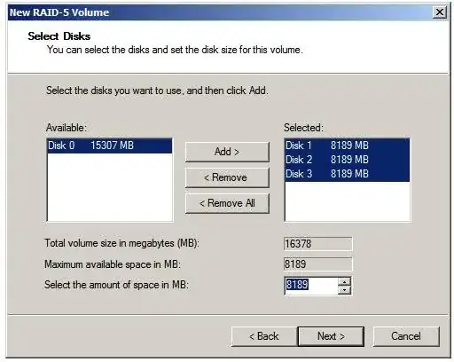

What you can do is go to computer management then disk management.
Convert all of them to Dynamic disks and then you should be given the option to create a new Raid 0 / spanned disk that will achieve what you want.
I can't quickly find a picture for RAID 0, but after making the disks dynamic, the options should be in the right click context menu. After clicking on it, you should get to a screen similar to this:
alt text
That being said,I highly recommend against this unless you have a good backup plan. I personally have 4x 1TB drives and use them as 2x 2TB raid 1's (although recently been thinking about just using them as normal disks with rsync or similar between them).
And remember, even if you go for the above, always backup your important files.
