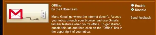

In the meantime, you can use this solution (just joking):

  • Your last sentence made me chuckle. :) Regarding your statement "the Fn key doesn't generate any scan-codes.", I think it actually does (see above - 57443) generate a hardware scancode. Not only that but I successfully used KeyTweak to map Fn to Ctrl and on a single-key basis it functioned identically; Windows did indeed see it. What it doesn't appear to do is generate a unique ASCII keypress value and/or support keypresses along with another key (e.g. Ctrl+c) which require a unique ASCII code for the combo. – Howiecamp Oct 01 '09 at 11:28
