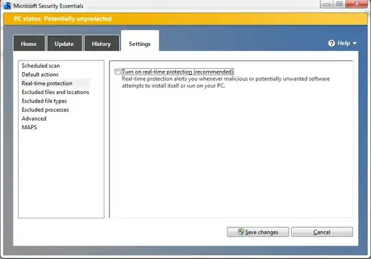

Just in case someone will face the same questions on Windows 8/8.1 - there is now build-in option to stop both Windows Defender-related services:
  • Windows Defender Network Inspection Service and
  • Windows Defender Service:
Turn off Windows Defender

    Author is using `Windows 7` not `Windows 8` and your answer only applies to `Windows 8`. – Ramhound Apr 26 '14 at 23:11
    It does not help for me (Win 8.1 prof). I disabled real time protection, turned off this app and there is still MsMpEng.exe consuming my CPU and disk. Computer is soo slow... – Tomas Kubes Oct 28 '14 at 19:56
  • @qub1n, well, this is kind of strange. It may sounds obvious, but have you tried to reboot your computer and after that check the check box from the image above? – Sevenate Oct 30 '14 at 17:01
  • Yes,I disabled it months ago. – Tomas Kubes Oct 31 '14 at 07:32
  • I also disabled on Windows 10 with almost the same steps. But there seems the notifications about the system at risk. But it was running all of the time when I was working and my disk was not be silenced (My computer is a bit old and it may be a special situation for this old computer but anyway there should be an error on the os), now it is ok when it is off. – Emre Guldogan Oct 23 '15 at 18:22
    this answer works for Windows 7. I was able to Disable Real-time protection and uncheck the "Turn on this app" option. After clicking past the dire warnings, the icon removed itself from the task bar and the unstoppable Windows service stopped. – pdwalker Apr 20 '16 at 18:56
  • @pdwalker I guess MS updated the Defender app for all OS versions at some point, so this UI now available on Windows 7 as well (when I was using Windows 7 it was not there yet). – Sevenate Apr 20 '16 at 19:15
  • On Win8.1 it does not work. The service is still running. – Anixx May 16 '16 at 20:26
