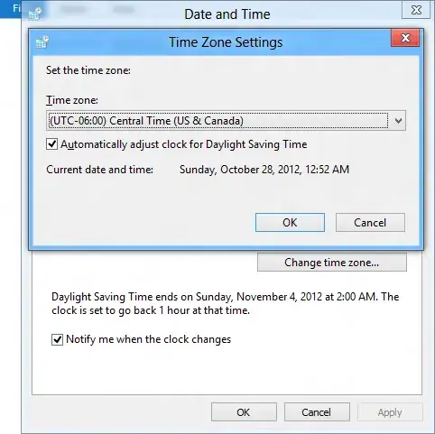

-4
You could just set your time-zone four hours off.
Caleb Jares
  • 2,649
  • 29
    Smart workaround... but the hardware and system clock will be messed up again when I use NTP (Internet Time), right? – jiehanzheng Oct 28 '12 at 17:46
