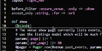

Running Mac OS X, using either Terminal.app or iTerm2, there is a strange artefact with the character rendering that I have a hard time explaining and an even harder time understanding. I'll start with a video of my screen so that you can see and example of it in action:
Strange terminal vim rendering
From the video you can see a few ways it is weird, for example, sometimes when I hit a letter in insert mode, the character is double printed. When I go into normal mode, the artefact remains. When I re-enter insert mode, hitting backspace copies the characters on the left to the position under the cursor.

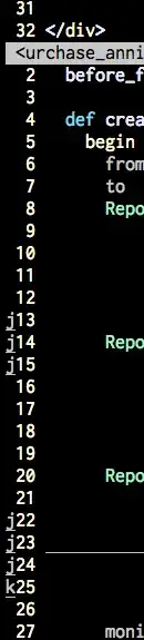

EDIT: I tried using the macvim Vim executable, and I still get strange artefacts, but they are localized to the left side of the screen, here is an example:
