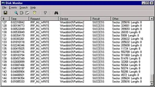

DiskMon can be used to inspect pure read and wites, although it doesn't tell you where these originate form it can already give you an idea of whether it is reading or whether it is writing and to what partition this is happening if you have multiple partition; as well as give an idea about the rate.

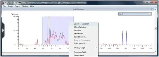

If that's not enough, you could attempt to use xperf from the Windows Performance Toolkit (available in the Windows SDK or the Windows ADK) to get an even more in depth sight of what's happening, whether it's from a high level of a low level, drivers or software; this tool reveals it all.
