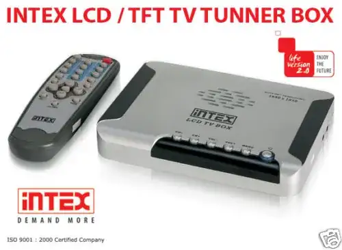

I have a PC monitor. I watched TV on this using an external TV tuner box just like this
https://dl.dropbox.com/u/57629104/INTEX%20SkyView%20LCD%20%20TFT%20TV%20Tuner%20Box.JPG
having ports : https://dl.dropbox.com/u/57629104/M501-1334-out4-hl.jpg and it worked fine.

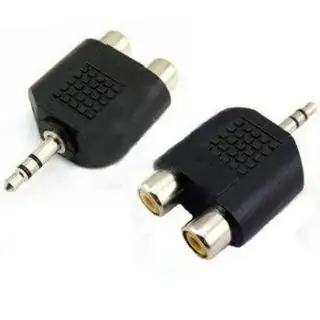

On the other side of the cable I have hooked both the audio cables together using the connector like this

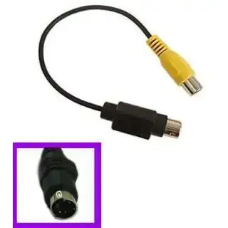

and on the remaining yellow video cable I have attached a connector like this
(rca to s-video) since the TV tuner only had the option for S-Video in. Moreover the cable shipped with the TV tuner box.

S-video uses four wires to carry two signals:
  • chrominace (the color signal)
  • luminance (the grey-scale signal)
The B/W picture you do see implies that the chrominace (color) connection is broken.
Check the S-video connections and cable. Try another S-video cable.
