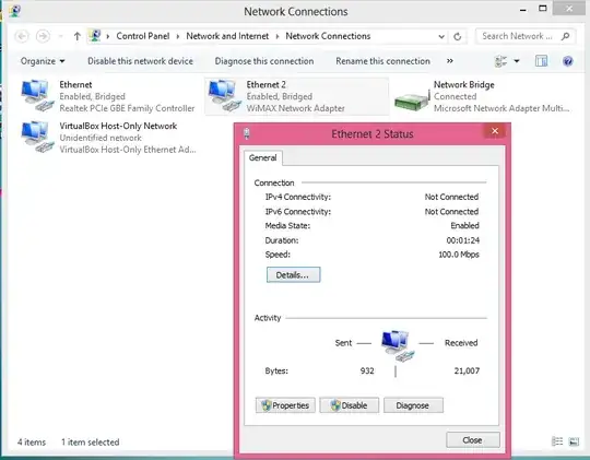

EDIT: After I did a bridge between the two connections, I lost internet connectivity. The following screenshot might help
With the bridge in place, I connected another PC to the router via an Ethernet cable. On that computer, IP addresses shown on the Router configuration page (192.168.1.2) seemed to be the right ones. However there was no internet connectivity on that computer as well.
