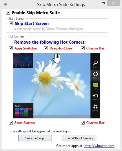

There is a program called Skip Metro Suite. You can use it for diasbling all hot corners of Windows 8. You can download from here: http://winaero.com/download.php?view.33
