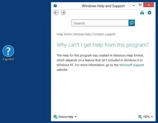

C:\Windows\winhlp32.exe installed with Windows 8 is a stub only (~10KB). It does not shows or open .hlp files! You have no need to erase this file.
There is optional update KB917607 (.msu) for Windows 8 which allows to work with .hlp files, but this update may be installed manually by the user only. After installing this update C:\Windows\winhlp32.exe will be more than 100KB (can't say exactly).

Clean Install Windows Pro RTM OEM, all the winhlp32 stub does is open the Help and support window. Right click open with or double click gets the support window.
It must be manually installed

    @avirk: Actually Moab's answer confirms what Maximus said, that while the EXE might exist by default, it is just a mere stub and will *not* actually open .HLP files, *and thus cannot act as an attack vector*. After installing the update the EXE is replaced with a bigger one that's not a stub and actually works, which is when it could pose a threat if infected .HLPs were opened. – Karan Nov 05 '12 at 17:03
