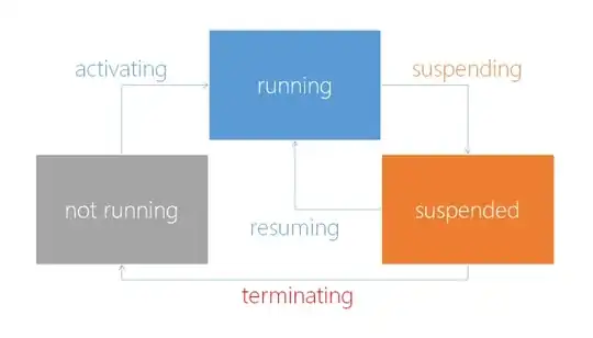

If I start a Modern-UI app and then switch to a different app or a normal program running on the desktop, what happens to the first app?
The app enters a suspended state — you can check its resources in task manager.
Apps will be suspended when you are not using them, this is for performance. When suspended you won't feel your system 'lag' (ie slowdowns attributed to running an intensive application in the background).
Windows 8 is designed to keep in mind that when any background app is not active, it should not use much CPU, so your system performs well in the active app.
Any Metro style app is in one of 4 lifecycle states at any given time:
  • Not Running
  • Running
  • Suspended
  • Terminated
As the app transitions between states, it receives lifecycle events that help provide a consistent and high performance experience to the user.
There are some MSDN blogs which can help you to implement what you want to.
Managing app lifecycle so your apps feel "always alive"
Being productive when your app is offscreen
Being productive in the background – background tasks

    Why is downvote? Please care to comment so I could improve the post. – avirk Nov 09 '12 at 03:50
  • This answers my question, thanks! (and I up-voted it too, don't know about any down vote.) – Mark Allen Nov 09 '12 at 04:21
  • @avirk What happens if I am downloading some apps from the store and it's running in the background? Are the apps still being downloaded or do they get paused? – mr-karan Nov 09 '12 at 09:06
    @thetechfreak they will continue download without suspend, Windows is using a `BackgroundDownloader` which will not pause the download when your app is not in foreground. Also you can download/upload without any interruption when your app is not in foreground. – avirk Nov 09 '12 at 12:52
    I especially appreciate the links - I feel much better about modern-ui apps now. – Mark Allen Nov 09 '12 at 19:26
