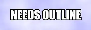

I am trying to put letters on an existing image that are outlined in a different color.
Example below. Note how the letters below have white color, yet the outline is in black. Directions on how to do that in Paint.NET or Photoshop or MS Paint would be great. Or is it a specific font that I have to use?

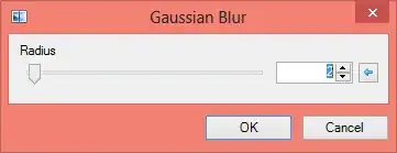

  3. Blur the lower with a radius of how large your outline should be:

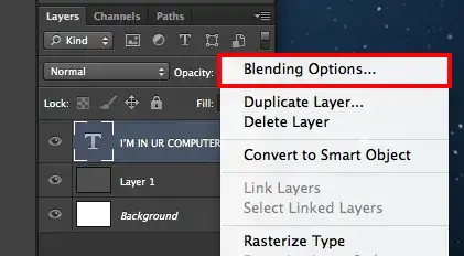

Photoshop
In Photoshop, to get outlines for any shape, check the layer's Blending Options….
Here, apply Stroke. Don't forget to set the right size:
And you're done:
