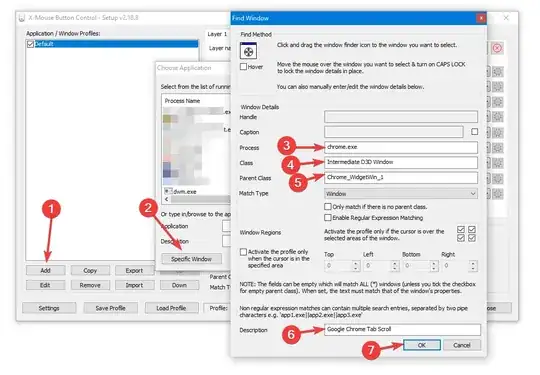

  1. Download and install X-Mouse Button Control.
  2. Open "Setup" from tray menu.
  3. Add a new profile for Chrome. Refer to the image below. Strings to copy: chrome.exe, Intermediate D3D Window, Chrome_WidgetWin_1, Google Chrome Tab Scroll.enter image description here

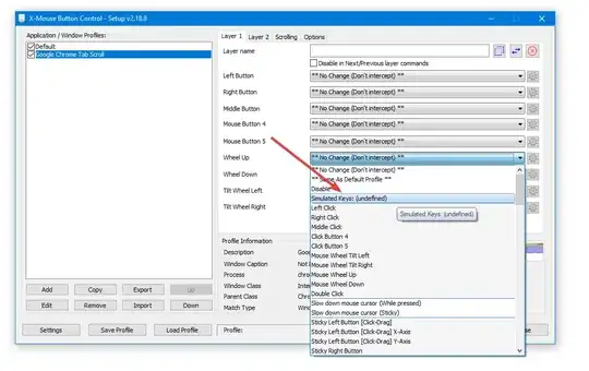

  4. Choose Simulated Keys for Wheel Up: enter image description here
  5. Enter {CTRL}{PGUP}, Check the "Only send if profile's process is active" option, and press OK. enter image description here
  6. Repeat 4 for Wheel Down.
  7. Repeat 5 with {CTRL}{PGDN}.
  8. Click on Apply.
Aaaand you're done
