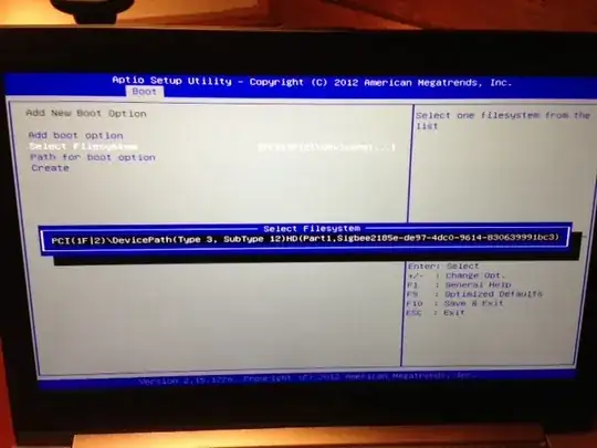

I just purchased an Asus Zenbook Prime UX31A-DH51 with Windows 8. I want to wipe the drive and do a clean install but USB is not listed as a boot option in the BIOS. Does this mean it is not possible?
Here is a photo of my BIOS options.
This is the only option I get when I click Add New Boot Option. Not sure if I can add USB here.
***** Update ***** Asus tech emailed and said: "Unfortunately with Windows 8 you can not boot from bios."

    What happens when you click on "Add new boot option", it should give you the option for USB. – Winter Faulk Nov 17 '12 at 23:45
  • I posted a second screen with what happens if I click add. That filesystem option is all I get. Not sure if I can add USB here somehow. – Chace Fields Nov 17 '12 at 23:50
  • When the system is booting I think you can hit F9 to get to the boot menu, is USB listed there? – Winter Faulk Nov 18 '12 at 00:01
    Can you try this? Press Escape to get into the boot menu. If the USB bootable device is not listed, enter the configuration menu and directly press `F10` to save. Press Escape again on reboot: This time the USB bootable device should appear in the menu. ( Source: https://wiki.archlinux.org/index.php/ASUS_Zenbook_Prime_UX31A ) – Hennes Nov 18 '12 at 00:12
  • @hennes Just tried that and nothing at all. Still only showing the SSD. – Chace Fields Nov 18 '12 at 03:39
    Drat. One more question: Is USB legacy support turned on or off. ( This is mostly needed when emulating older PS/2 keyboards and mice for an OS which does not support USB. E.g. DOS. However it also affects some USB boot options. ) – Hennes Nov 18 '12 at 17:10
    Can you insert the USB stick, reboot, press Esc during the Asus splash screen to bring up the EFI boot menu and post an image of the same? Also, in the second BIOS screen you clicked on **Select Filesystem**. What about the top-most **Add boot option** or **Path for boot option** or even **Create**, *with* the USB stick plugged in? As a last resort maybe you can try **Launch CSM** to enable legacy BIOS booting and see if that allows you to boot from USB or not. – Karan Nov 18 '12 at 23:07

I just went through the same pain... but I found a workaround.
  1. Plug in your USB drive
  2. Turn the Zenbook on
  3. Enter UEFI (BIOS) through pressing ESC or F2
  4. In 'Boot' tab: 'Disable Fastboot' (*)
  5. Press F10 to save & exit
  6. Immediately press ESC or F2 again
  7. In 'Boot' tab: your USB drive should be listed - change the order
  8. Press F10 to save & exit
  9. Your Zenbook should now boot from the USB drive
  10. profit
(*) = and 'Enable CSM' if you want to boot in legacy mode
If that does not help, you might need a more recent firmware version.

We just got a few of these in at work and they are a right PITA to wipe and clean-install windows with, especially the usb-3 only ones.
To enable booting to a USB device you need to set secure boot to disabled (in the security tab of the bios) and enable CSM (on the boot tab of the bios)
You can then select a USB boot device.

  1. Power on
  2. F2 to enter BIOS
  3. Tab to Boot
  4. "Secure Boot" -Disabled
  5. "CSM + UEFI" selected in OS Mode Selection
  6. F10
  7. Hold F2 to Enter BIOS
  8. Check boot -> Boot Priority to see if connected USB is listed

I hit this same issue. However, if you plug in the USB stick before you boot, the choice will turn up. You can then save and boot away.
IN THEORY.
I tried to boot onto an Ubuntu USB - I see the grub loader but nothing happens after that. But that's a different issue :-)
Last note: Once you remove the USB stick, it will disappear from the options. Next time you want to bot from USB (or a USB DVD, whatever), you'll need to do this again.
EDIT 12-12-12: OK, I managed to get this working with Ubuntu. What I needed to do was turn off the "Secure Boot" option in UEFI/BIOS. Once I did this, it was pretty smooth sailing. Ubuntu installed and all was well with the world once more. This page here: https://help.ubuntu.com/community/UEFI was the best help I found.
Note: Disabling secure boot also meant that I had no issues at all getting both a USB and USB CD-ROM to appear in the boot menu on startup (hitting ESC). You do need to have them plugged in on boot (as it happens so fast), but messing around with the boot order as I mentioned previously became unnecessary.
As always, YMMV - this worked for me, I hope it helps you.

This thread helped me a lot. I'll add my 2 cents:
Asus R509C with Windows 8 pre-installed:
  • USB device is plugged in
  • F2 to BIOS
  • Switch to "Boot" and set “FastBoot” to Disabled
  • Switch to "Security" and set "Secure Boot Control" to Disabled
  • F10 to save and exit and immediately press F2 to BIOS
  • Only then could I switch to "Boot" and set “Launch CSM” to Enabled
  • Now select a boot option. My USB option didn't say USB, it was just [ 8.0.7]
  • F10 to save and exit - booted right to USB

Those are not BIOS setup screens, they are UEFI setup screens (which is the successor of BIOS). Note that UEFI cannot per se boot from media that are made bootable for a BIOS (like install media for most operating systems or rescue systems, which were released at a time where UEFI was not yet available, like last year or so) unless you enable CSM (compatibility support module) support.
So, either you have a boot media that is UEFI bootable (maybe in addition to bootable via BIOS), then you just have to attach it and it should be possible to select it in that menu, or your media is "only" BIOS bootable, then you have to enable CSM support and reboot and go into the BIOS setup of the CSM module to configure booting it from there.

  1. Enter the BIOS setup menu by pressing and holding F2 key when powering on.
  2. Switch to "Boot" and set “Launch CSM” to Enabled.
  3. Switch to "Security" and set "Secure Boot Control" to Disabled.
  4. Press F10 to save and exit.
  5. Press and hold ESC key to lunch boot menu when the notebook restarts.
