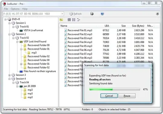

I've had good results with IsoBuster when nothing else worked on an important disc (Roadkil worked with an HDD but not for this disc unfortunately):
The Pro version's not free but you can click the "Free Functionality" button when prompted during install and see if it suffices.
I also highly recommend you try accessing the disc with multiple drives, especially from different manufacturers (but the drives should have similar capabilities, i.e. don't use DVD+RW and DVD-RW drives since they might see different track layouts on the same disc). The reason for this is that some drives will often be better than others at reading all or different parts of the same damaged disc. The age of a drive and the amount of usage it has seen obviously also matters in how well the read laser can perform, especially with R/RW discs burnt using a writer (as compared to commercially stamped discs).
IsoBuster allows you to create so-called managed image files (.IBP + .IBQs) and "fill in the blanks" if a different drive can read sections of the disc that yours could not. Once all the blanks are filled, the user or audio/video or raw data can be extracted from the managed image in various formats, including plain files/folders (when relevant), ISO/BIN+CUE images etc.
As a last resort after you've attempted filling in the blanks using multiple drives, follow the various tutorials on the net and polish your discs carefully (and never in a circular manner!) using toothpaste or Brasso, or get them "resurfaced" at a shop that offers this service. Once you've done this, you can try filling in the blanks once more and hope the final missing bits can be retrieved successfully.

    Wow, excellent answer that lays out a method that is categorically better than most others mentioned in these situations. Thanks a lot for the tip. – chronometric Apr 28 '15 at 07:24
    Thank you so much, I managed to recover some old family photos with this! Also wanted to add that the free version of IsoBuster does have the crucial feature of being able to fill in the gaps of missing sectors, so that I could get 90% of the disc on one device, and the sectors that didn't read I managed to recover on another device, but because Isobuster knew which sectors were missing, it recovered those straight away and it worked perfectly. – nmu Jan 21 '20 at 17:58
  • The "Extract Raw but convert to User Data (only supported on CD)" feature worked perfectly for me. Files that refused to copy or stalled the entire process with conventional tools like xcopy and robocopy were copied all correctly as far as I can tell. Many jpg files, which would definitely show scrambling at the bottom of the image, and all look great at a glance. – Allen J May 11 '20 at 00:14
  • I've tried the IsoBuster. The same result as for the `robocopy`, `xcopy` or cmd.exe `copy` command. May be at begining it seems faster than others, but not in critical case. All has had stuck on copy the same corrupted files. Windows 8. – Andry Oct 18 '20 at 15:34
