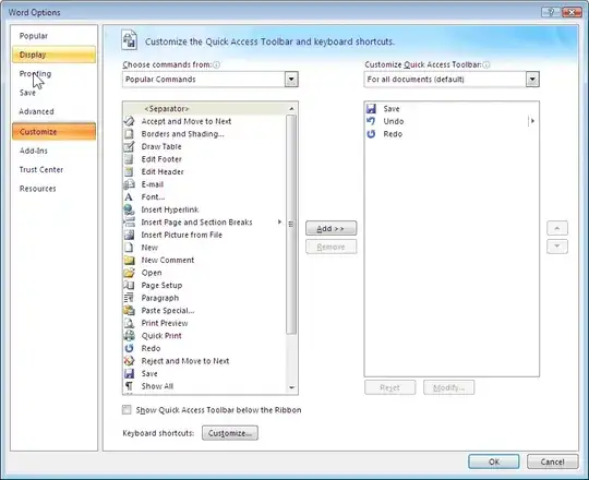

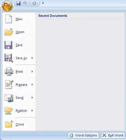

Add and enable the alternate language under
Start / Programs / Microsoft Office / Microsoft Office Tools / 2007 Microsoft Office system Language SettingsClick the round Office button:
Click Word Options:
Click Customize:
In the Choose commands from drop-down menu, select Home Tab instead of Popular Commands
Find and highlight Left-to-Right Direction, then click the Add button to move it to the Customize Quick Access Toolbar section
Add the Right-to-Left Direction command to the QAT as well
Now in the QAT you will see the RTL (
) and LTR (
) buttons, which you can use as required
I don't see the option. This is ms word 2010 but probably similar. What is one supposed to do from here? http://i.imgur.com/JfUReYY.png and there's no home tab in the dropdown http://i.imgur.com/ir0r9IF.png – barlop May 24 '13 at 11:51
