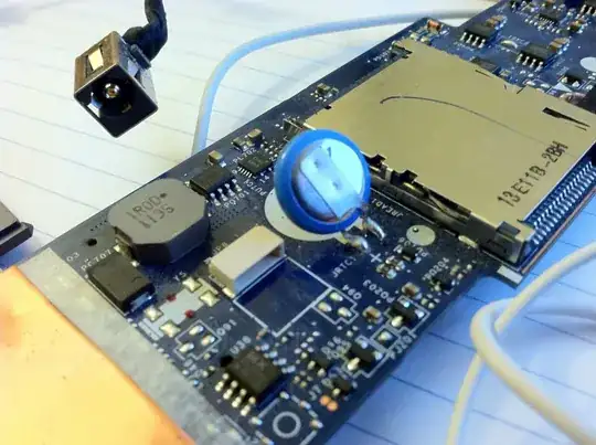

Disclaimer: I'm sort of a noob, and this is a long post. Thank you all in advance!
summary: completely dead laptop with no signs of life whatsoever (suddenly, for no apparent reason)
Here's the deal:
Lenovo Y470 (a few months past warranty with no water or shock damage). It stopped working suddenly (no lights, no sound, even when connecting adapter with or without battery).
I tried a different adapter (same electrical rating), but no luck.
I disassembled the thing completely, and tried plugging in the adapter and looking for signs of life with all different combinations of components installed (tried all combinations of RAM, CPU, USB power cords, screen, etc plugged in).
no luck. Then, I noticed (as I was plugging in the adapter to try for the millionth time) that there was a "spark" for an instant when I first connect the adapter to the power jack. The adapter's LED would then flash (indicating it isn't working or charging). So, I thought the power jack has a short of some sort (due to bad soldering or something). Scanned virtually every single component on the motherboard, and tested the power jack connections with a multimeter. No shorts or damage to anything on the entire motherboard.
Now I'm thinking I need to replace the motherboard.
But, my actual question: What does this "shorting" when connecting the adapter signify? (btw, the voltage across the power connections and current through it drop to virtually zero when the adapter is connected and "sparks", and they stay that way). The bewildering thing is that there are no damaged components, and the voltage across adapter terminals returns to normal after I disconnect it (so it's not damaged).

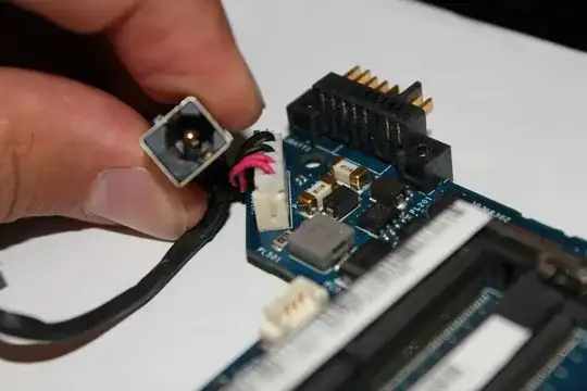

Please take a look at the pictures (of the motherboard's power connection and nearby components) and see if I'm missing something completely obvious...
Motherboard model: LA-6881P
Laptop model: Lenovo IdeaPad Y470

  • BTW, I checked for damaged capacitors; couldn't find any... It really doesn't look like a damaged motherboard, yet it just won't work... Has this ever happened to anyone of you before? What should I look for to figure out where the damage is? – Cashew Nov 26 '12 at 03:23
  • I also checked the components marked F12A (see first picture). I'm assuming this is a 12A fuse. It has zero resistance (therefore, I'm assuming it is still functional and isn't the damaged part). Are my assumptions correct? – Cashew Nov 26 '12 at 03:27

  • By connecting adapter, I meant power adapter (where the power supply connects to the motherboard through a 4-pin connector) as seen in the last photo – Cashew Nov 26 '12 at 15:58

  • I did notice there is a small battery (it's soldered on to pins, so I cant replace it without some re-soldering). It's reading 2.9V when the motherboard is unplugged and when it is plugged in to power. – Cashew Dec 02 '12 at 01:05
  • Are you talking about the battery that sits inside the motherboard? that's what I'm referring to. I tried running the laptop with and without actual battery that the laptop runs on. – Cashew Dec 02 '12 at 01:06
  • I added a picture of the motherboard battery (I assume it's CMOS) – Cashew Dec 02 '12 at 01:11
