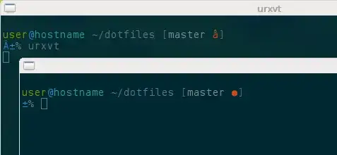

When I start urxvt the unicode characters do not render correctly.
For example
● renders as â
However, if I then start a new urxvt from inside the first terminal everything renders correctly.
There doesn't appear to be any difference in the environment between the two terminals.
What could be the difference between the first invocation and the nested invocation? I suspect the font is not correct in the 'outer' instance, but I'm unsure how to check the font of a running X window
UPDATE: It seems that the locale is not correctly set up in the app launcher for xfce4, but presumably the shell inside the first terminal inits it's own locale, meaning that both shells have the same locale.

screenshot demonstrates the problem:

  • Try to run `LC_ALL=ru_RU.utf8 urxvt` from the current X session. If the Russian (and other Unicode) chars became correct you are in case when your environment have been running under C locale. So check locale settings for `xfce`. For example if you are started it in `.xinitrc` try to set locale before run like `LANG=ru_RU.utf8 exec startxfce4`. – Alexander I.Grafov Feb 24 '18 at 20:07
