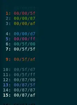

My colors are off. Specifically, the bold version of colors 1-6 is broken:
The color of each (emboldened) index should match the color of the text beside it. It does not.
This is generated from this gist, modified to include colors #0-15. (It's identical except the , 16 on line 25 is removed.)
Update:
Here's what's going on: Bold #1 is using color #9, bold #2 is using color #10 and so on. I confirmed this by changing color9, color10, etc. in my .Xresources file.
I'm using solarized .Xresources and would rather keep colors #9-15 colored differently.
Furthermore, the bold colors are correct in xterm.
Why is urxvt Bold #0-7 using colors from #8-15, and how do I stop this?

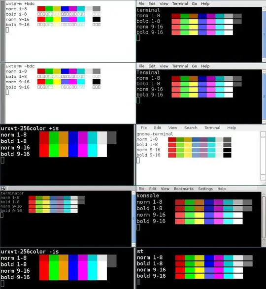

It's not clear which behavior is "right". (I prefer "bold" = "bold font".) Historically, some terminals treat SGR 1 ( \e[1m ) as "bold", and others treat it as "intense". Current terminals exhibit a mix of behaviors. Top row in each window is colors 0 through 15 in "bold". Second row is without "bold". (-bdc and +bdc is the XTerm equivalent of URxvt's -is and +is -- not sure why it only appears to affect color 0 on my system)
various terminals' treatment of bold vs intense
script to run the terminals in this image
