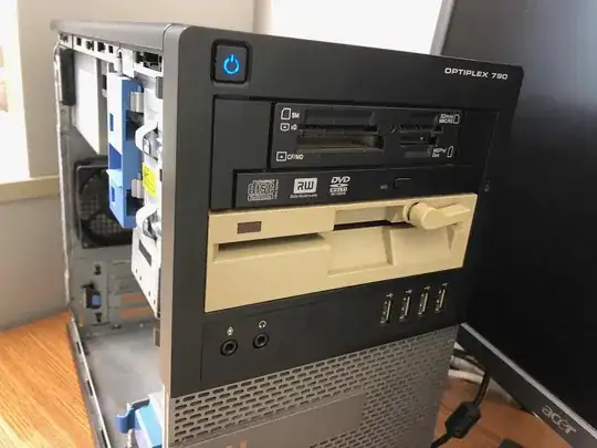

HI I have just installed the bought USB-FLOPPY CONTROLLER (sold by DeviceSide.com ) in a new DELL OPTIPLEX 790 running WIN 10 on a SSD. Works great. Here is the provider of the USB-Floppy controller. Here my Optilpex 790 with WIN 10 & 5.25" Floppy Drive USB-FLOPPY_DISK-CONTROLLER and here the USB COntroller with one internal USB 2.0 socket. Reichelt Electronix LogiLINK USB COntroller and I also have got on ebay the TEAC-FD-55GFR-5-25-5-1-4-Floppy-Drive. Works great with the supplied controller and WIN 10 Image-Prg. You an read Floppies only not write! But it`s good to make *.img Files which can be unzipped by 7zip.
