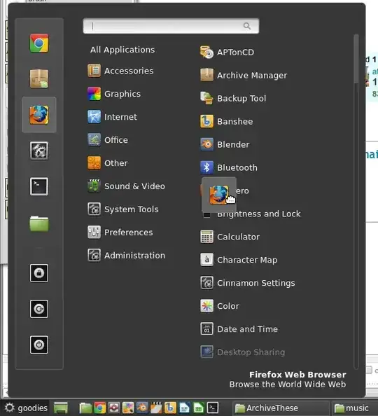

In the menu which appears when you click the Menu item on the taskbar in Linux Mint 14 (Cinnamon), you can dock items on the left, by dragging them to the area (there are some default already, like Firefox, or Terminal).
It's easy to rearrange them, or add to them, but how can I remove ones that I don't want anymore? I tried dragging it away (and releasing on the desktop, for example), but on release, the icon returns to its place on the dock. There doesn't seem to be a trash icon to drag it into.
If I right-click on the Menu option, I can enter Edit Menu but while this gives the option to modify the items inside the menu, it doesn't seem to have any options for the dock on the left-hand side.
Thanks

You just need to drag it over the application menu, though you're right - it seems like any of the ways you mentioned should do it. (And agreed, none of them do for me either).

  • Thanks, it's weird I didn't drop it there by chance. I hope they add a visual indicator for this method, or add the other methods mentioned in future releases, but I'm generally happy with Mint now :) – ataulm Dec 08 '12 at 10:33
    @ataulm Agreed, it took me a bit to figure it out the first time as well. Cinnamon is a pretty well done GUI, a great recovery from Gnome3, in my opinion. Have a great one! – nerdwaller Dec 08 '12 at 16:21

Hover mouse over desired left side menu item and press Delete, this will automatically remove the item selected (ex: Firefox, Software Manager, Terminal, Files, Shutdown, etc.).
Navigate to the desired app on the menu. Ex: All Applications->Internet->Firefox Web Browser. Right-click on the application. Here you can add/remove from panel, desktop or favorites. The left bar is the favorites.

Edit the gsetting entry "org.cinnamon favorite-apps" , for example with dconf editor. In my case drag and drop was not working.

  • Where does one find the dconf editor, how do you use it, and in what way should that be edited? – fixer1234 Jul 22 '18 at 18:15
  • You have to install it (search for "dconf editor"). The entry is a list of strings separated by commas. To remove firefox for example, remove the "firefox.desktop" string. – cass Jul 23 '18 at 14:02
