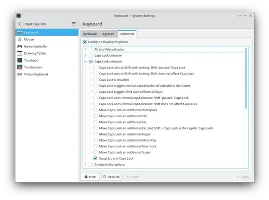

Plasma On Wayland
If you have Plasma (KDE) on Wayland, please go to System Settings -> Input Devices -> Keyboard -> Advanced, and on the second "Caps Lock behavior" item, check "Swap Esc and Caps Lock".
This has been tested on Plasma 5.27.
