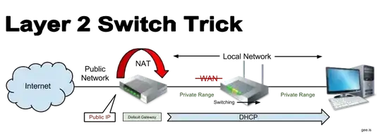

Problems arise mainly because the NAT tables on one device fill up or lose track of a particular connection, this type of configuration will cause issues with peer-to-peer technologies that are unable to effectively trace back the network path, MTU path discovery may not function or break and gaming/media services that use uPnP probably will not work unless reforwarding these services manually. [Source]
Solution
enter image description here Reconfigure the second, inside router as a layer 2 switch, by disabling its DHCP server.
