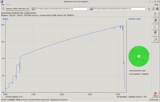

There is a tool called dvdisaster that can create a map of the disk that identifies the unreadable areas:
Running a scan in dvdisaster
It does not generate a picture of the location of a particular piece of data, but I does provide you with the location of the damaged areas.
You can find this tool packaged in Debian Linux: https://packages.debian.org/dvdisaster
